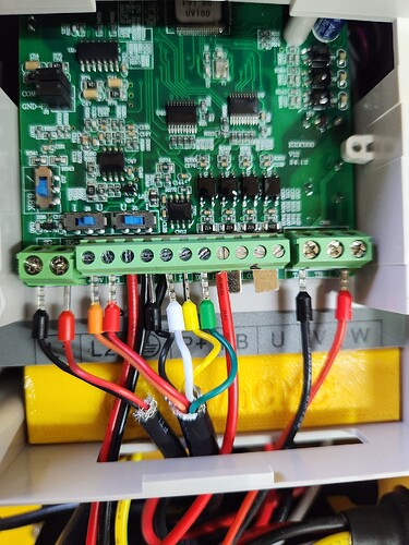

The blue/white wire solution I may have misunderstood from your post here: Does PWN spindles work forward and reverse - #9 by Chris
The yellow and green wires I’m mentioning were inside the PwnCNC VFD internal wiring (pic below). The picture was taken as found from the factory. Swapping them fixed the rotation issue.
If you think it’s still a problem, I can swap them back and change the VFD setting you mentioned.
