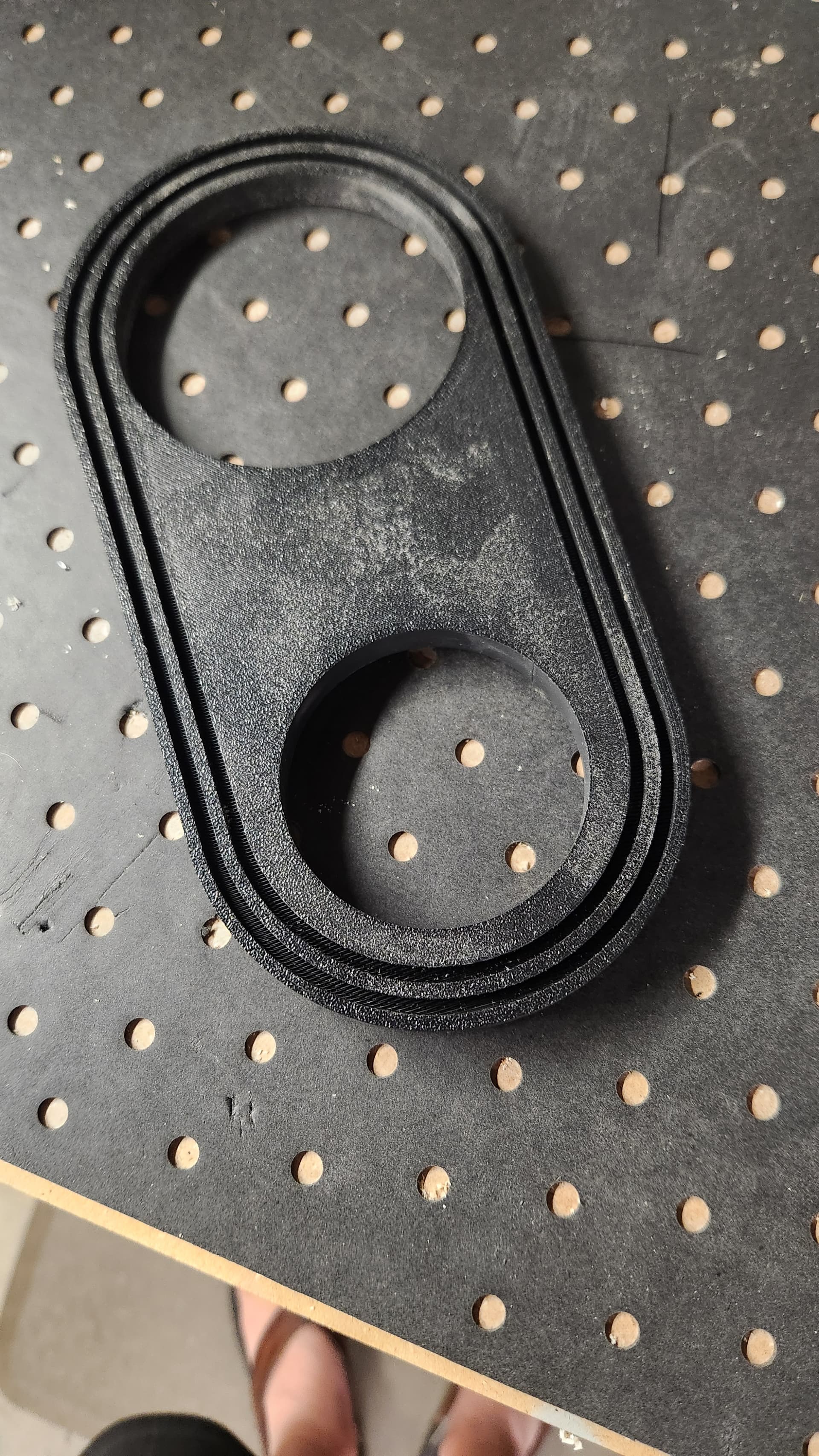

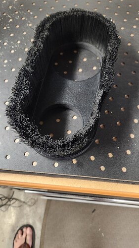

This is the last version of this experiment, as it is now working as expected. I redesigned the dust boot and added a bellows. It now has a double row of brushes

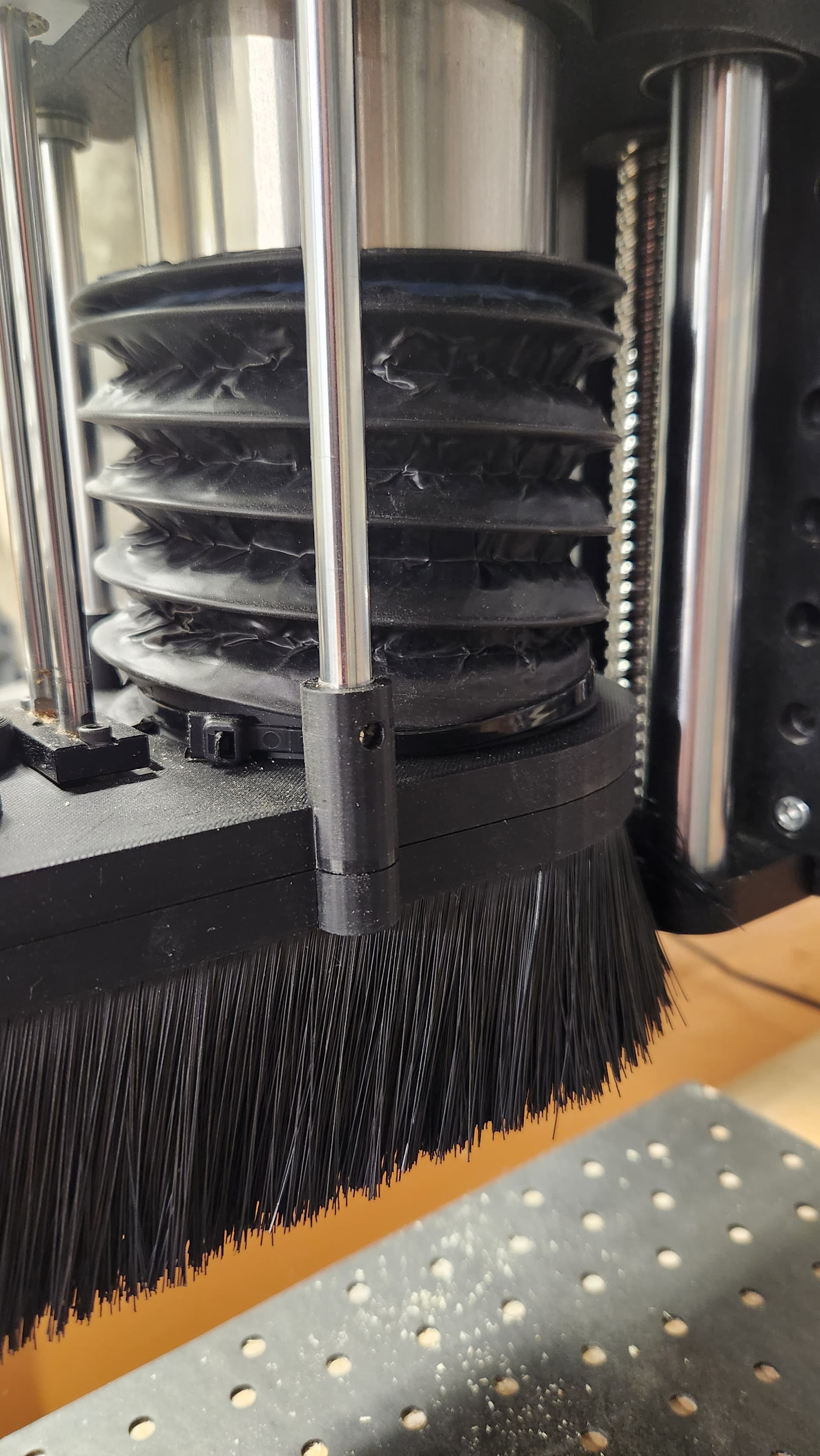

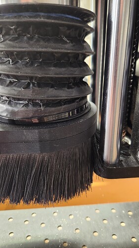

This is the bellows, this pretty much stopped the dust leakage

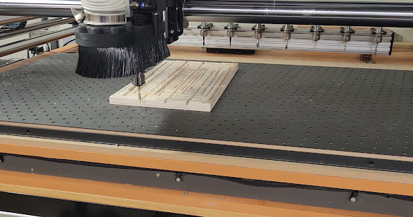

And a video of some random cuts

This is using a new spindle assembly, 3d printed with Carbon Fiber Filament, I’m also running Masso Beta 5.100b.

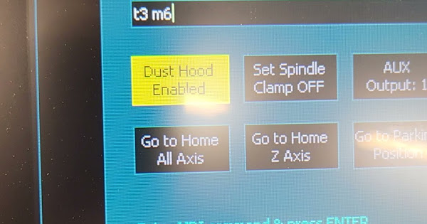

That allows me to control the dust boot independently
OK, I’ve got CnC envy!! That is probably the most effective dust boot I’ve seen!
Thanks, lots of versions were printed and tossed to get to this point.

I like the independent control of the dust boot in the midi screen, which is in the beta. Also like the unlimited line limit as opposed to the 2000 limit. But

There’s already the independent control of the Dust Hood with the stable versions unless I’m missing something.
MDI window
Interesting, I missed that documentation completely.
