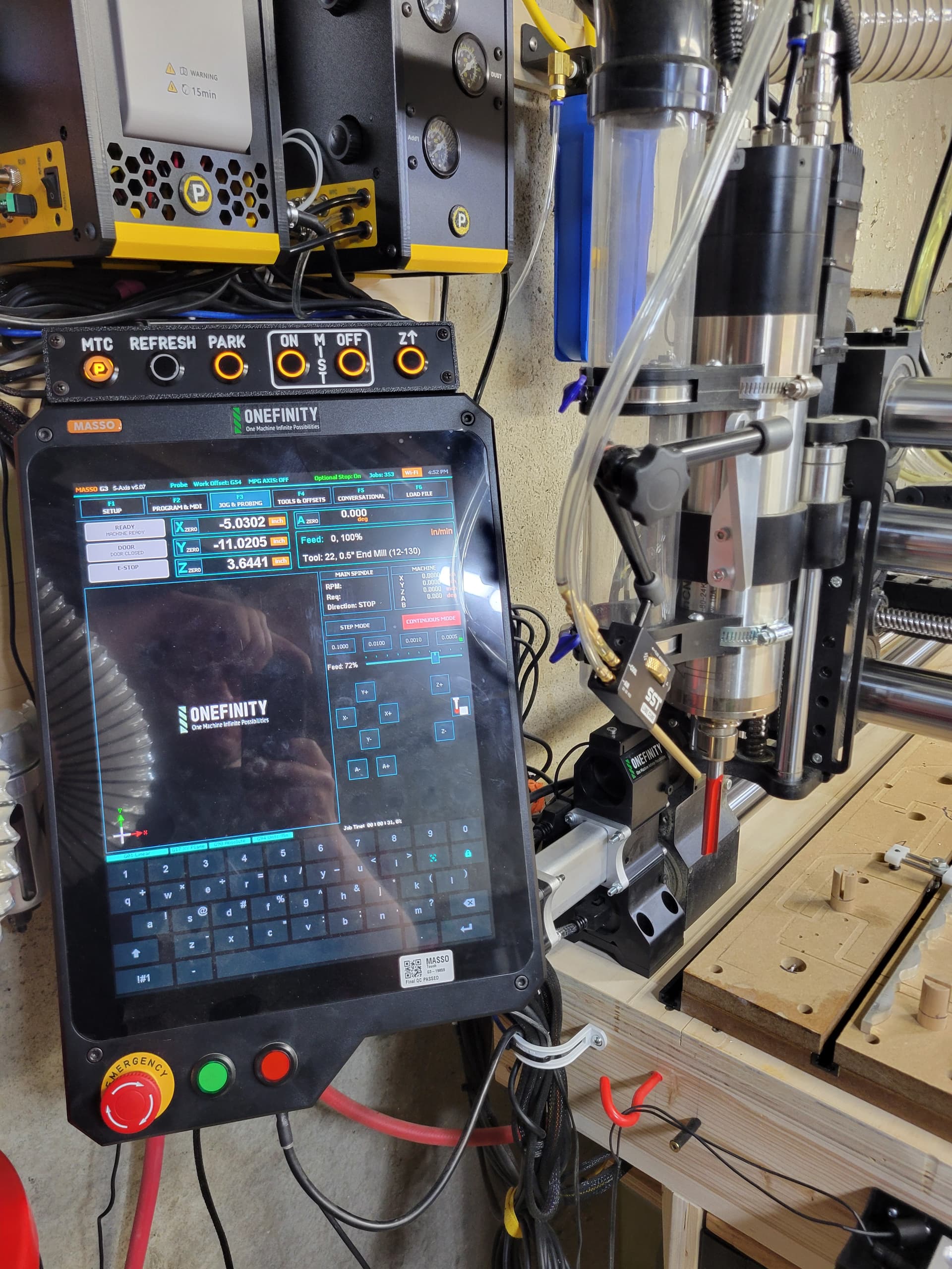

I installed the SST Lube Cube on my machine. So far it has been excellent.
I have the Pwn ATC system, and the pneumatics enclosure has 3 solenoids; two are used for the ATC functionality, and the third is unused. You can set the third air solenoid for whatever you want. I used the third solenoid in the pneumatics enclosure to turn on and off with Lube Cube. It was already pre-wired. It couldn’t have been easier!
If you do not have a pneumatics enclosure, I think the 24V solenoid from SST is all you need.
You can wire it up to an output on Masso, then in the F1 screen select the Mist coolant to that output.
Pro Tip - if you set the output as a Flood coolant, you can benefit from the shortcut button on the Masso F3 screen to turn on and off the coolant. For a while i did this, and then eventually put in a switch panel that controls the mist on/off.
