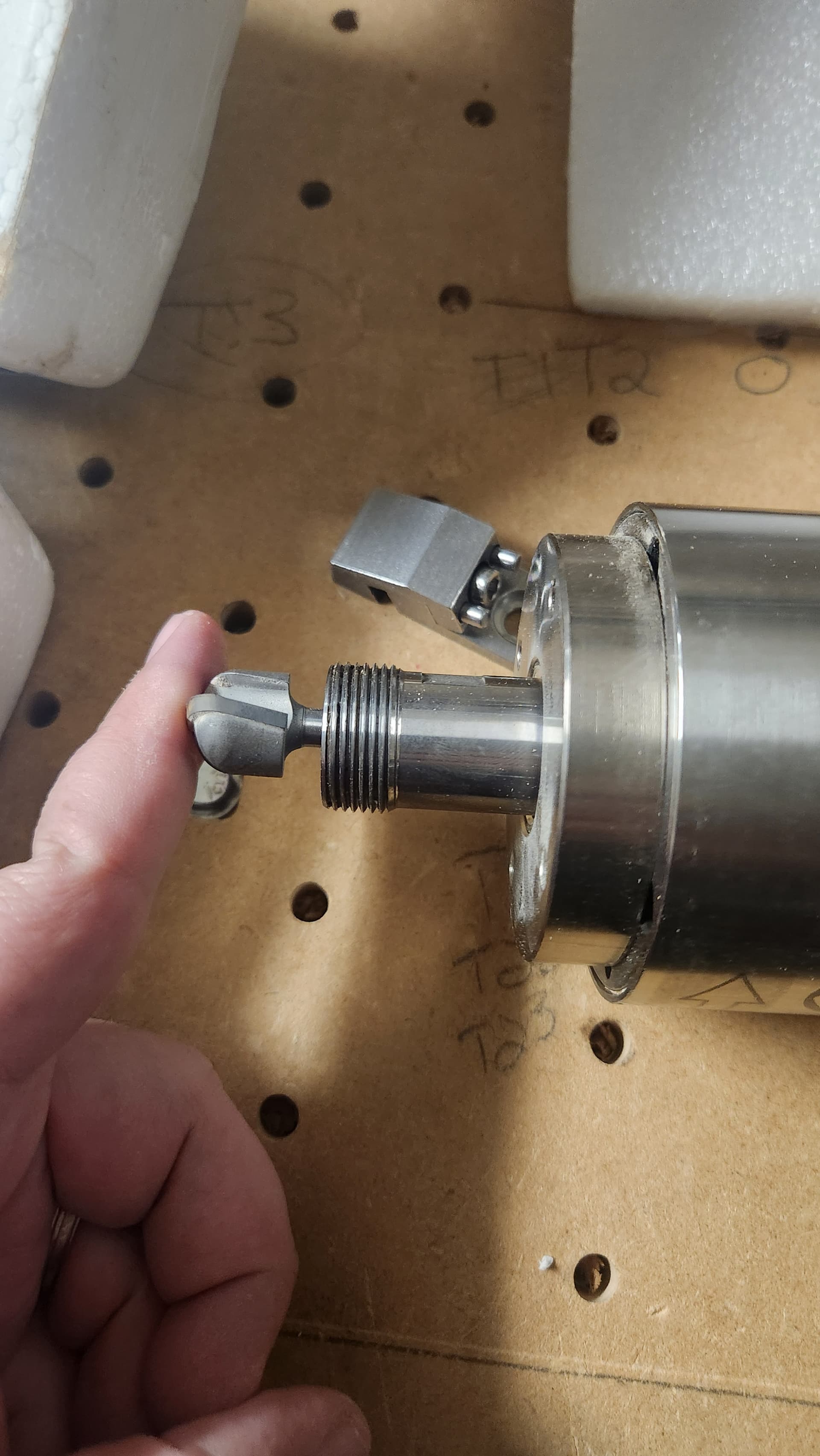

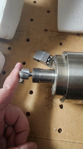

I’ll re-phrase…Can you tell me the length of shank that the tool can be inserted into the spindle until it bottoms out?
Pretty far…
I can’t find my er20 nut… but
Much thanks, that helps.
