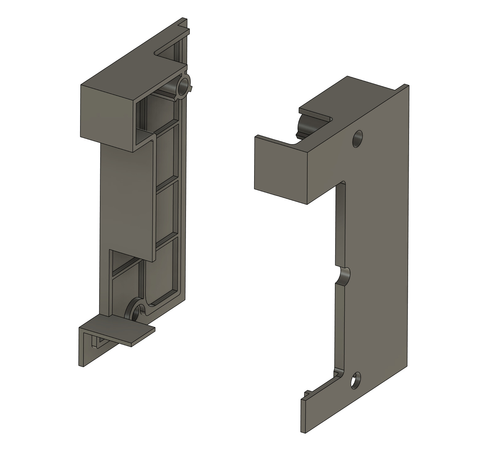

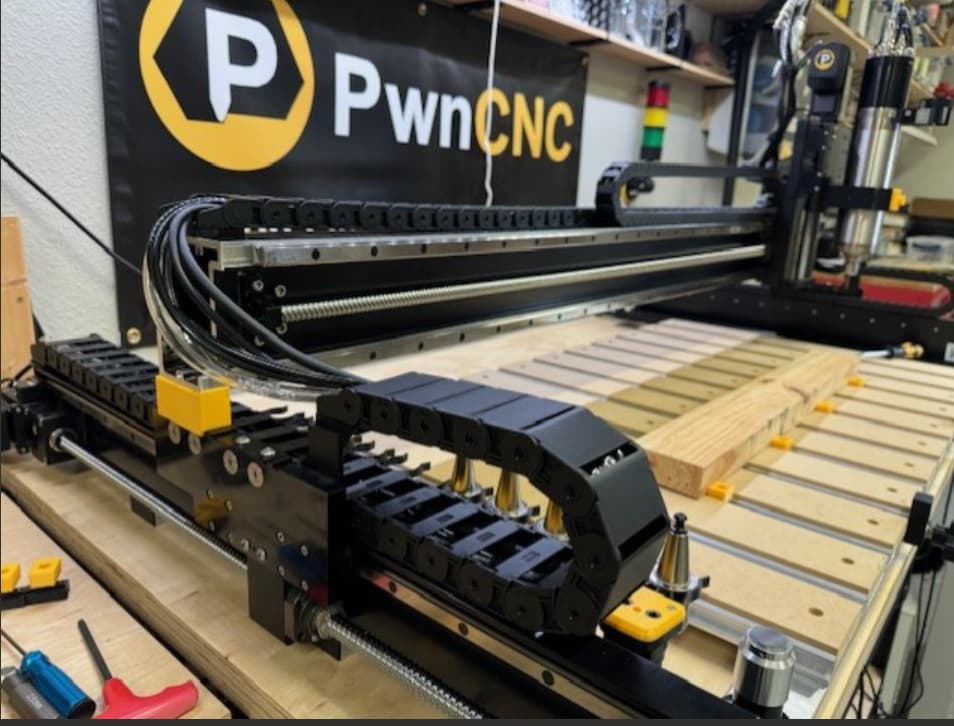

During the conversion of our Shapeoko 5 Pro to a Pwnoko… I’ve had to remake a variety of parts in 3d so I can redesign them to suite my needs.
Here’s two parts that were recreated exactly… the left and right X gantry end-caps.
It’s far easier to 1-1 recreate a part then start modifying it.

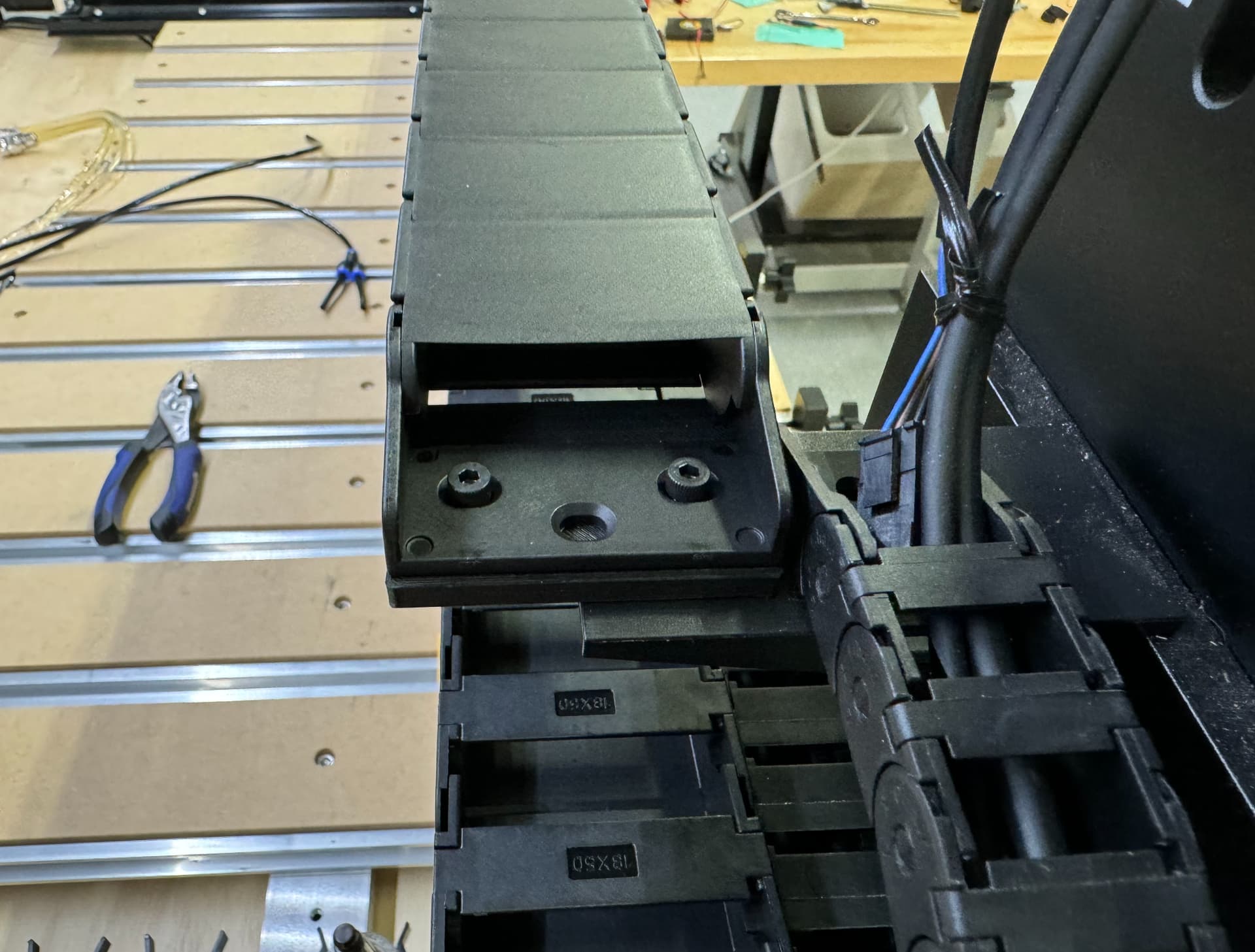

In this case i’m needing to modify the Left side to allow for the various tubes and wires related to our ATC.
This is part of a larger 18*50 cable chain modification.
