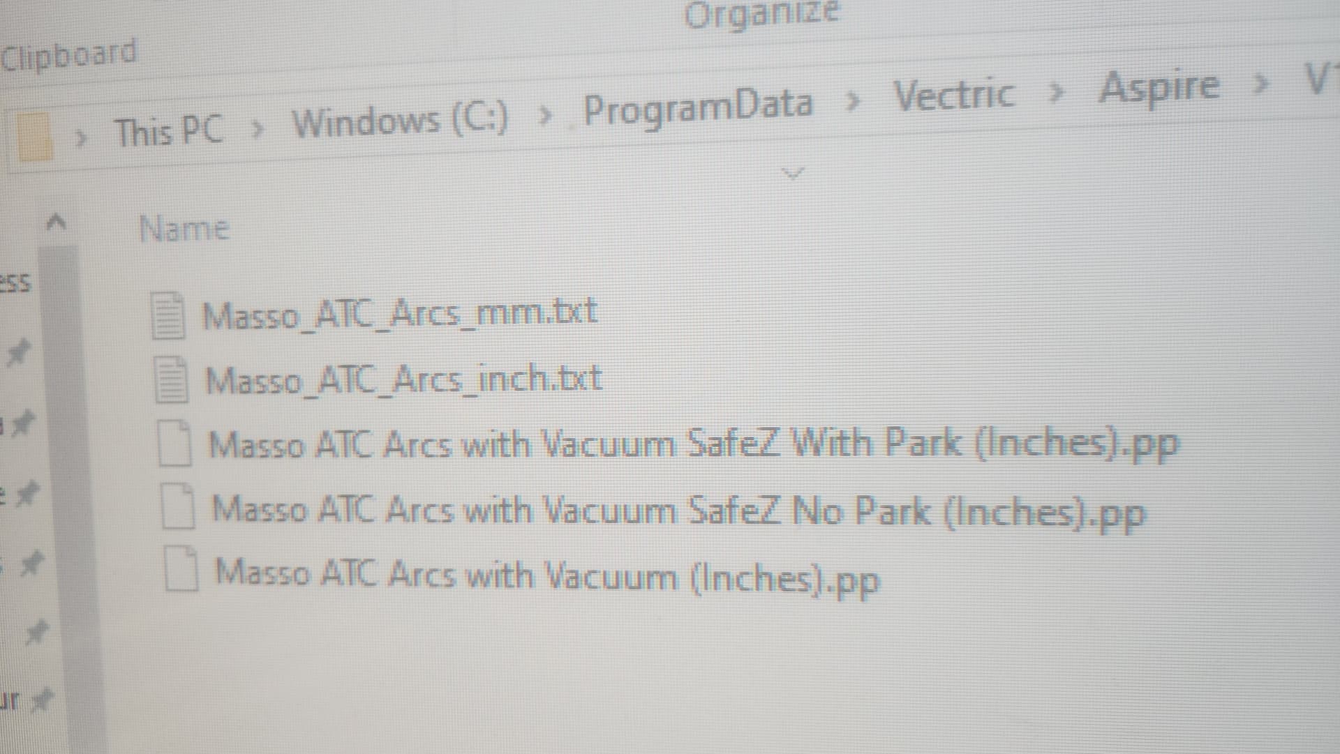

I got it from the first statement. If that’s what the post processor you use is called i appologize for misinterpreting. These are what I use.

Yes, i have an elite, yes i have atc functionality, correct i am not entering txxm6 unless i want to.
The text documented ones are what comes with, the others are flavors i modified
