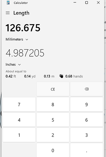

126.675mm or a scooch shy of 5"

Wow! Precision down to 6 decimals! That’s fancy rocket tolerances, there! Lol. Just busting your chops. I do love the open source attitude at PWN.
