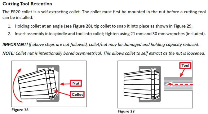

It sounds like the collet isn’t installed in the nut correctly. You should hear a distinct snap and you should be able to turn the nut over and the collet not fall out
https://support.pwncnc.com/kb/article/253-er-collets-a-how-to/

You shouldn’t have to push too hard.
Basically put them in at an angle, then push them from the side bringing them straight. To remove its roll back and snap out.
