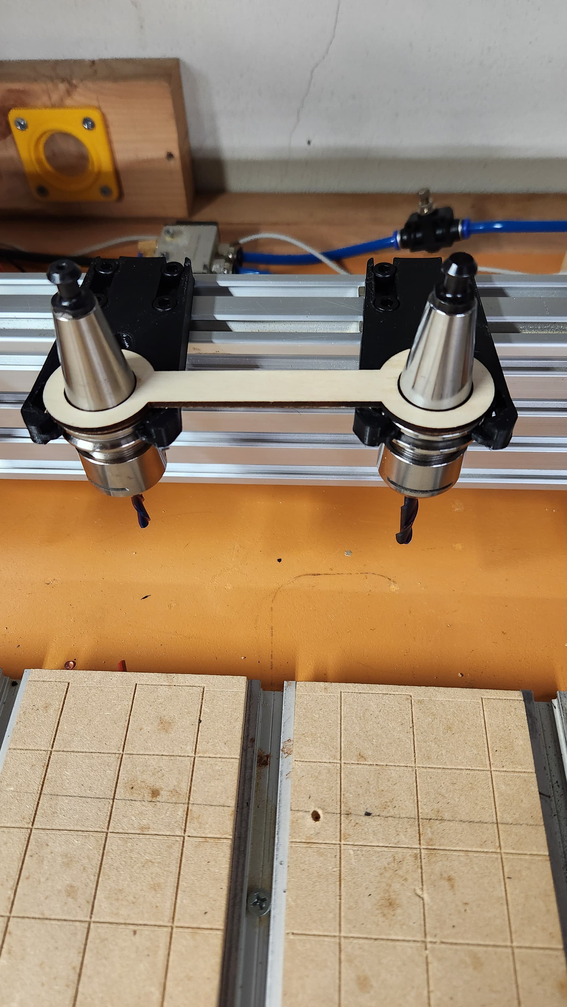

Tool spacing fixture
I did the math, divided it out, and cut this out on my laser. Made quick work of getting those tool locations. I just loosened the screws on the clips and retightend them after moving, rinse and repeat 9 times. No adjustments were necessary afterwards.
