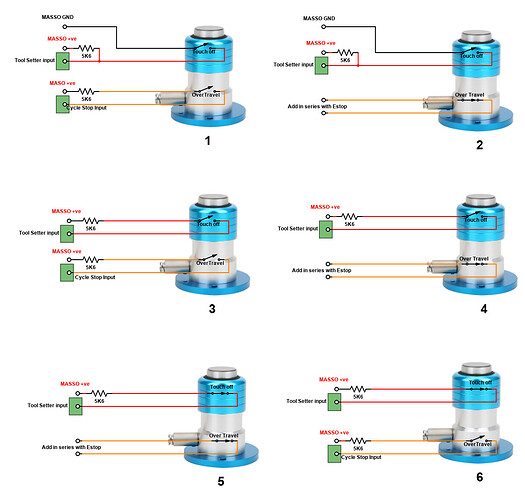

Good day. I am in the process of getting ready to set up the four wire PWN tool setter. The description of the tool setter is that it is a NC item for the setting switch, and the over travel switch. How do I set it up for the Masso Touch controller (Onefinity Elite) so that the over travel switch (NC) activates ‘cycle stop’. I have been to the Masso forum, and they have some info to help. Using a multimeter, I can confirm that the two contacts for the tool setter (metalworking version) are in fact NC. I have added this picture to show some wiring diagrams from the Masso forum.
The information you’re looking for is right here, but you’ll lose the red button on the touch to utilize the over travel sensor.
https://support.pwncnc.com/kb/article/257-tool-setter-inlet/
I personally haven’t tried adding it to the estop
