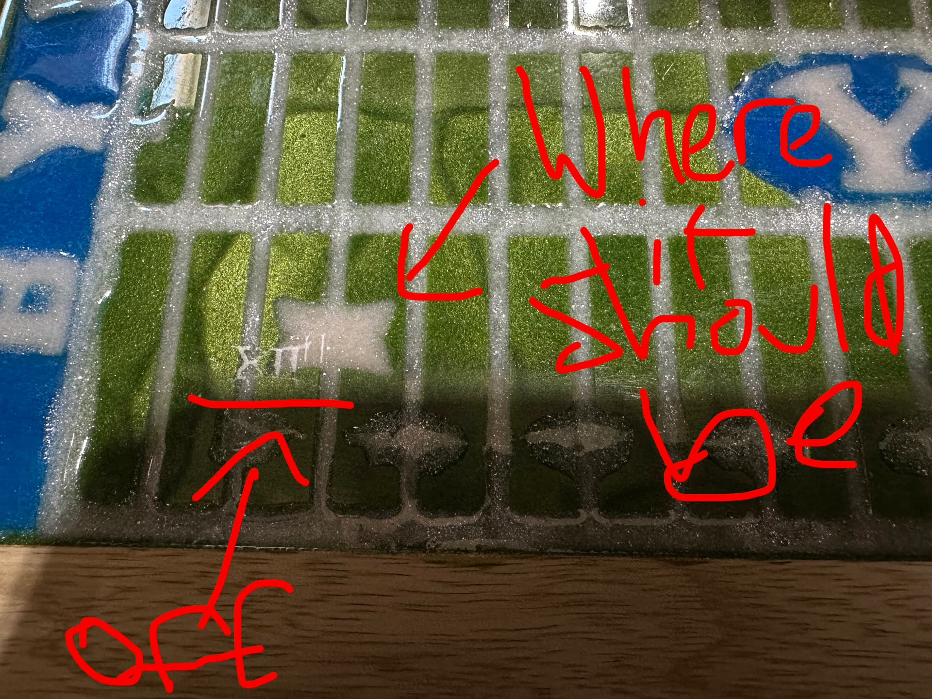

Also can you describe a bit more what you mean by “it is off”?
Perhaps others will have ideas. Also any chance of sharing some photos of the issue and of the machanics of the machine could give someone a clue.
Here is a photo for more detail on where it is off
I did do the calibration wizard, but I am going to do it again just to be certain of things.
