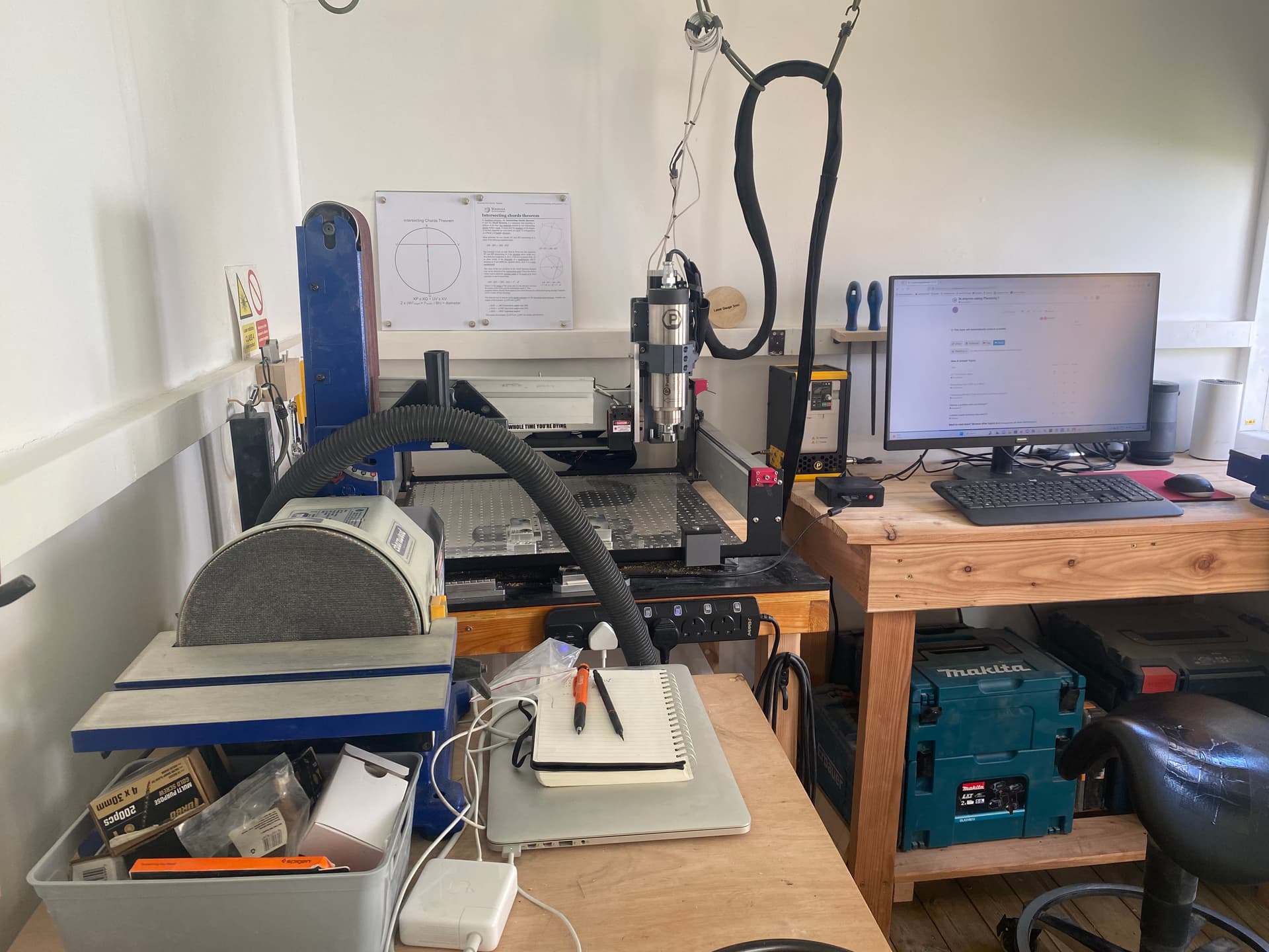

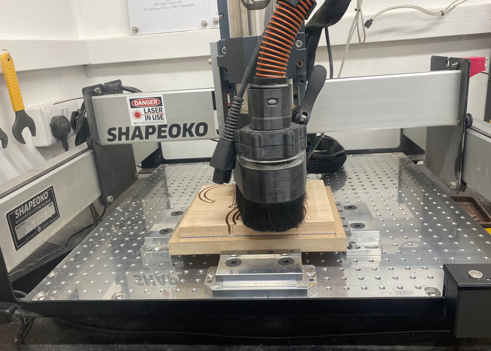

@NerdCaveCraftworks I purchased this system for my 4 year old Shapeoko SO3 and could not be happier. It was indeed plug and play thanks to Chris looking at an image of Carbide 3D controller first. I had to plug in the leads for mains power, spindle power and a PWM connector. It has been absolutely faultless in operation. Highly recommended. I also purchased the V7 dustboot kit.
Images showing set up:

@QCDvacuum Always great to know that good support is easily accessible. I like your Saunders Machine Works workholding system by the way, I’m also a fan of theirs and have been watching their NYCCNC channel for quite a long time before I committed to buy my machine.

It gave me an instant improvement in workholding repeatability, adjustment and security and the fixture tooling plate made the machine far more rigid. I also used three SMW stiffener bars too. The SMW system products were expensive anyway and even more so getting them shipped to the UK. I would not happily change the current system for anything else.
Keeping my SMW modified machine encouraged me to change the original belt adjustment system, which I really hated. I can now adjust all three belts accurately in a time of around 20 seconds per belt. I adjust the Gates GT2 x 9mm belts to a frequency of C3 (130.813 Hz) using a guitar tuner and they stay tensioned for a good eight months at a time.
