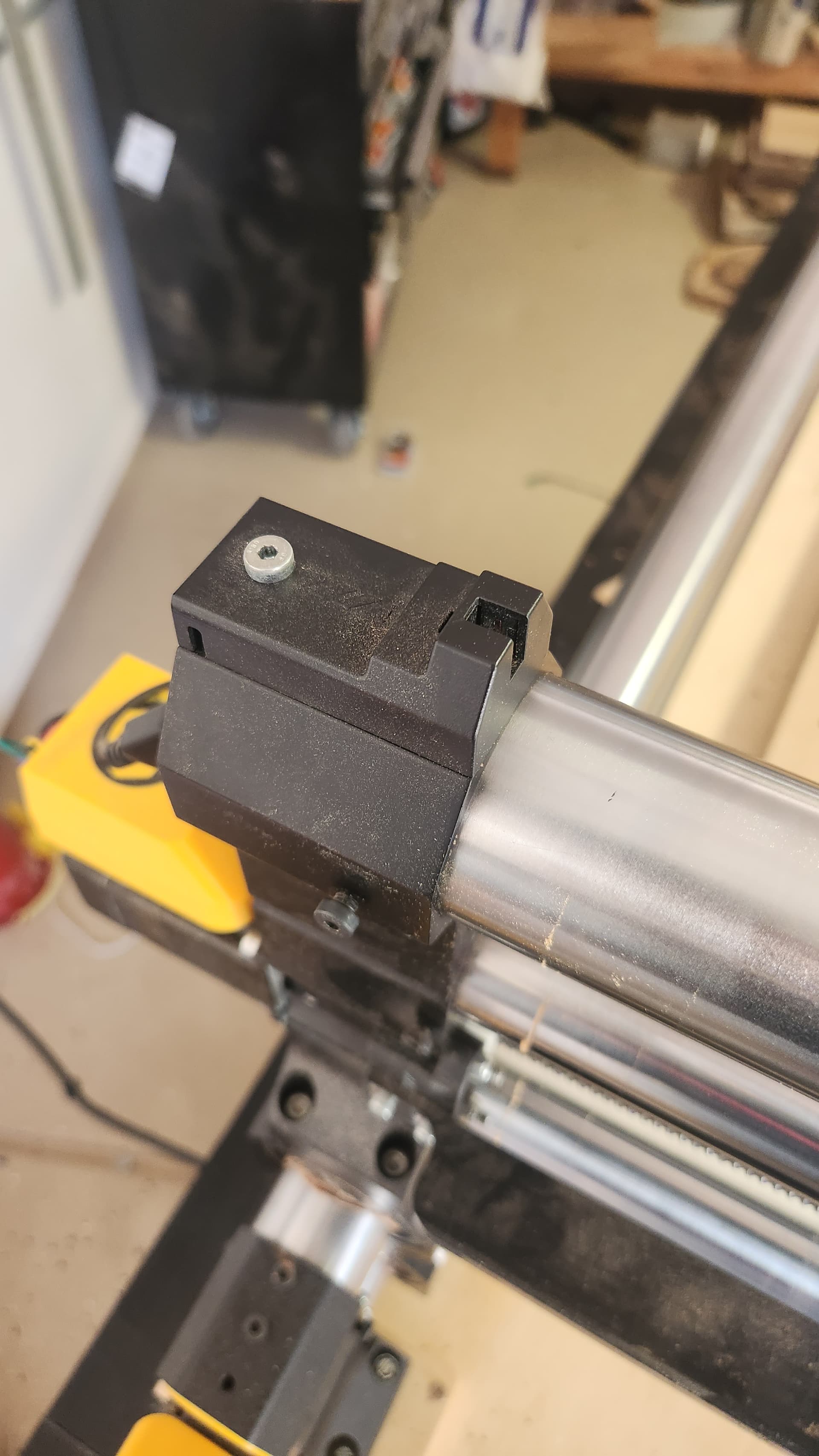

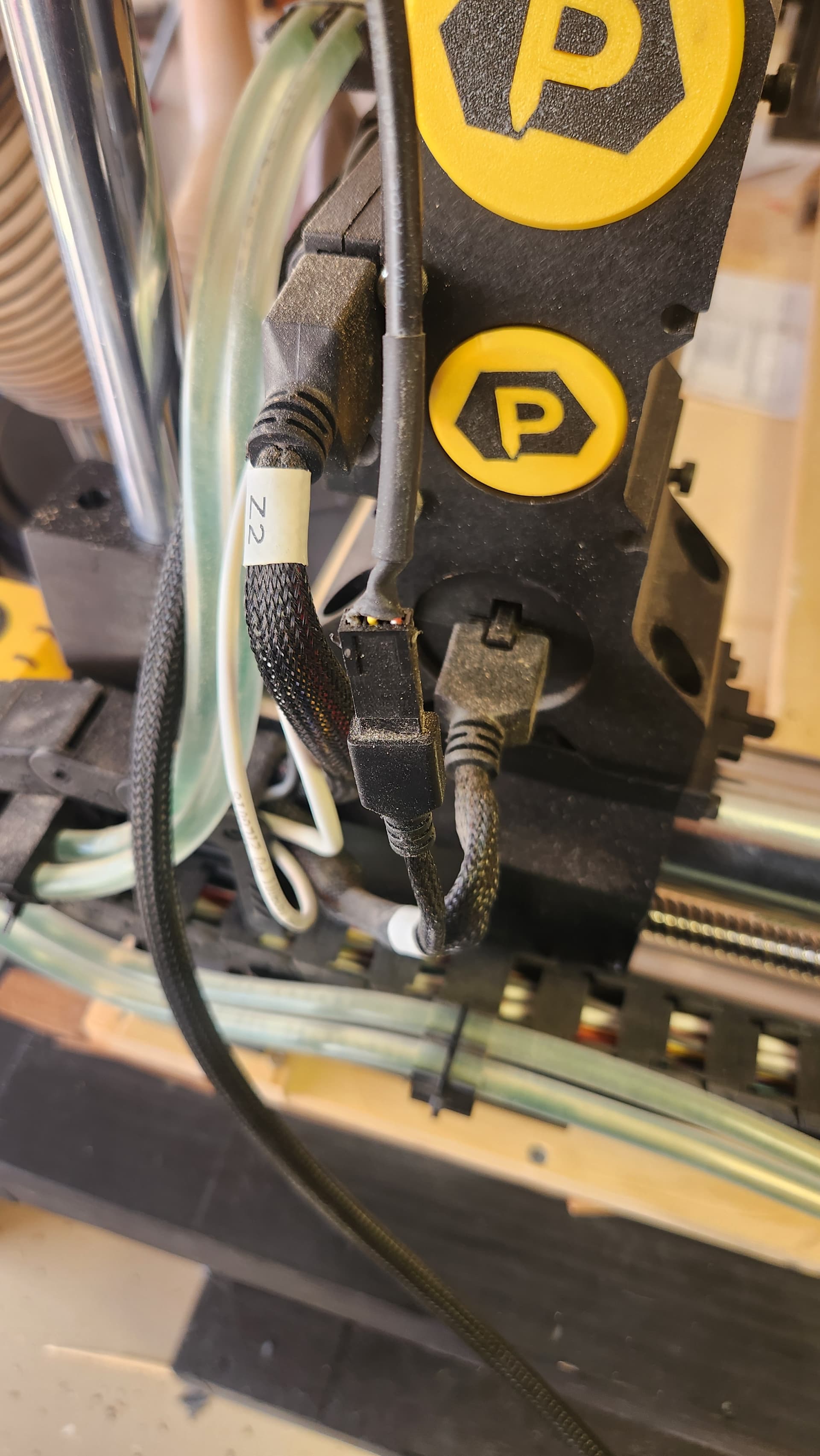

What it took was a stretch of 22/3 wire and a male/female 3 pin micro molex connector, and a mechanism to move the limit switch pin. My neighbor just happens to be a metalworker and was kind enough to tap m3 screwholes where i needed them.

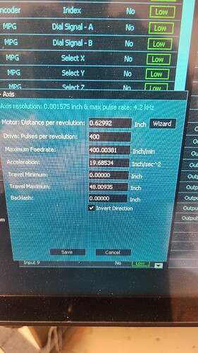

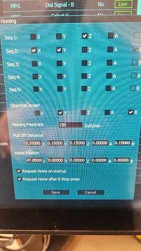

The last part of the equation was playing with numbers so it went the full length without coming up short or hitting the y1 rail.
