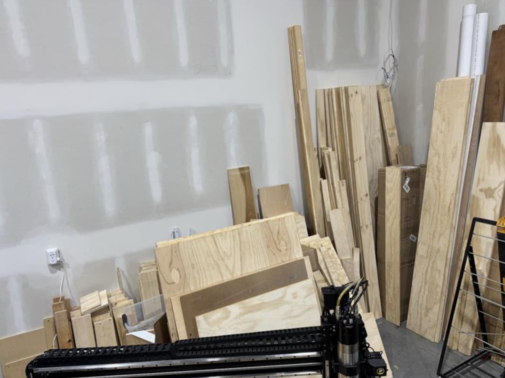

I’m thinking it’d be really nice if we take all of this scrap wood we’ve collected over the years either building the fixtures or projects…
and somehow organize it onto a rack that’s easy to walk-up to and grab a piece.
To the left, in-between the garage door and red beam… would be a large project-wood figure to store pieces ready for carving. I’m thinking of wood that if someone comes in and wants to see the Dominator doing a carve, that we can grab a piece from here, measure/design or have pre-made designs ready to go on the controller… secure the stock and start carving.
Has anyone seen something like what i’m after? I’m hoping to get inspired for how to build this figure.

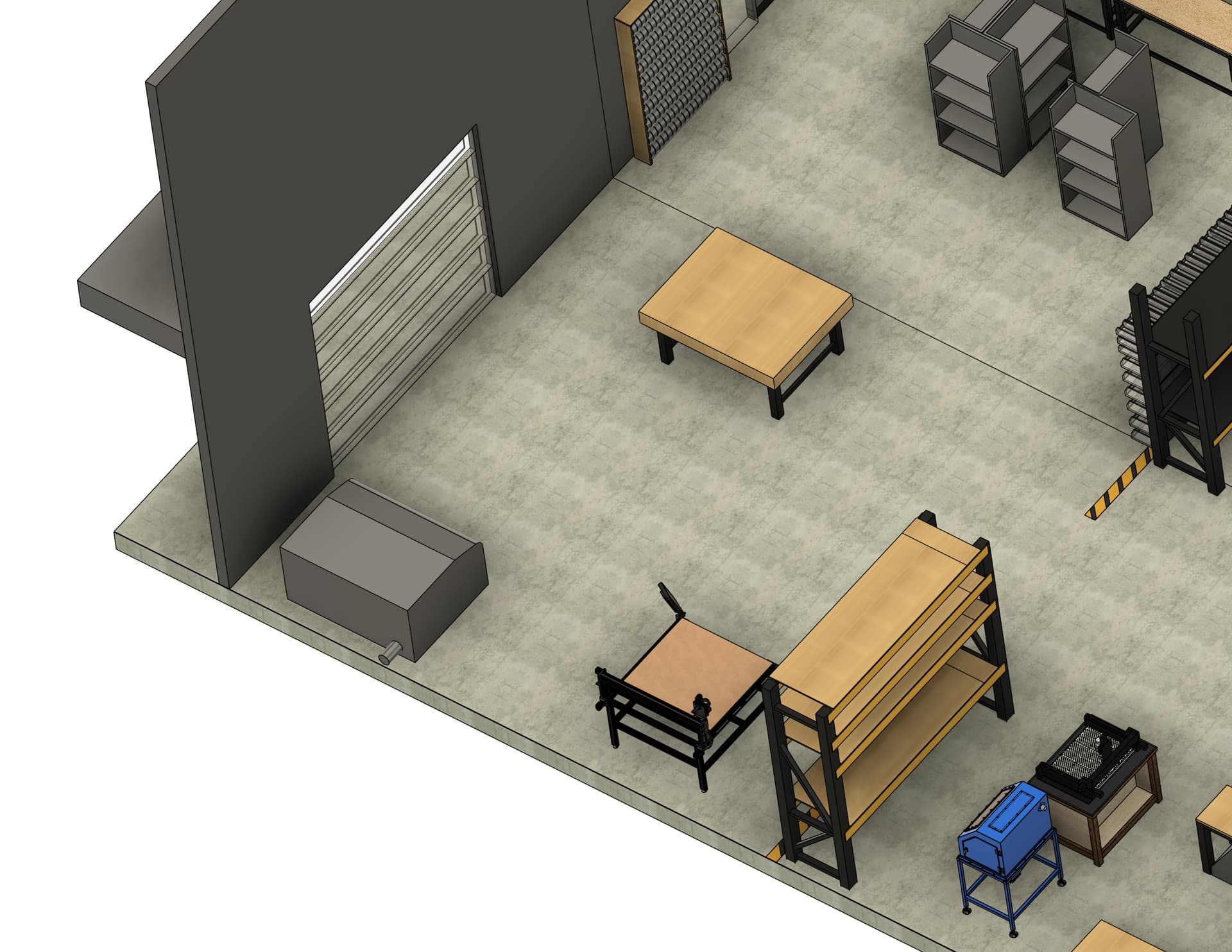

Bonus photo is of the shop/demo area. The scrap wood is currently taking up the spot where our CO2 laser will live (still in the old place till this is cleared out).
The assembly table will be moved more in the middle as a place to gather around when talking to customers or bs’ing.
The dominator sits next to a large pallet rack with a bench devoted to carving reasons… like storing bits and partial projects, etc.
On the other side of this pallet/bench is the HDM and blast cabinet.
Either side of the pallet/bench can be used for production if we need to pump out parts.. and it’s secure enough of an area that we could safely add caution tape on the floor to keep customers clear when in operation.
The red-beam isn’t in this graphic.. but on the store side is a large filament rack that’ll display Push Plastic filament ready for purchase by anyone who comes in.
