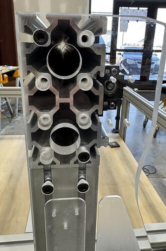

We’ve worked hard to ensure the machine is extremely rigid. Our main gantry extrusion is indeed a true 80x160mm 8020 extrusion with tons of internal structure.
This image doesn’t do it justice either…
In this image I’ve got one of our smaller rigidity upgrades that showcase the amount of thought we put into this machine. I’ve already sat upon the gantry, even with the acrylic gantry plates, and there is no flex. When we replace these acrylic with properly machined aluminum the rigidity will only improve.
We have similar rigidity upgrades for the bed as well. Although our image at the top shows only 3 horizontal bed extrusions, there are smaller upgrades that increase the framework and overall rigidity.

The comparison of the gantry is astounding! There is nothing else remotely similar in its internal structure. That single picture truly speaks a thousand words!

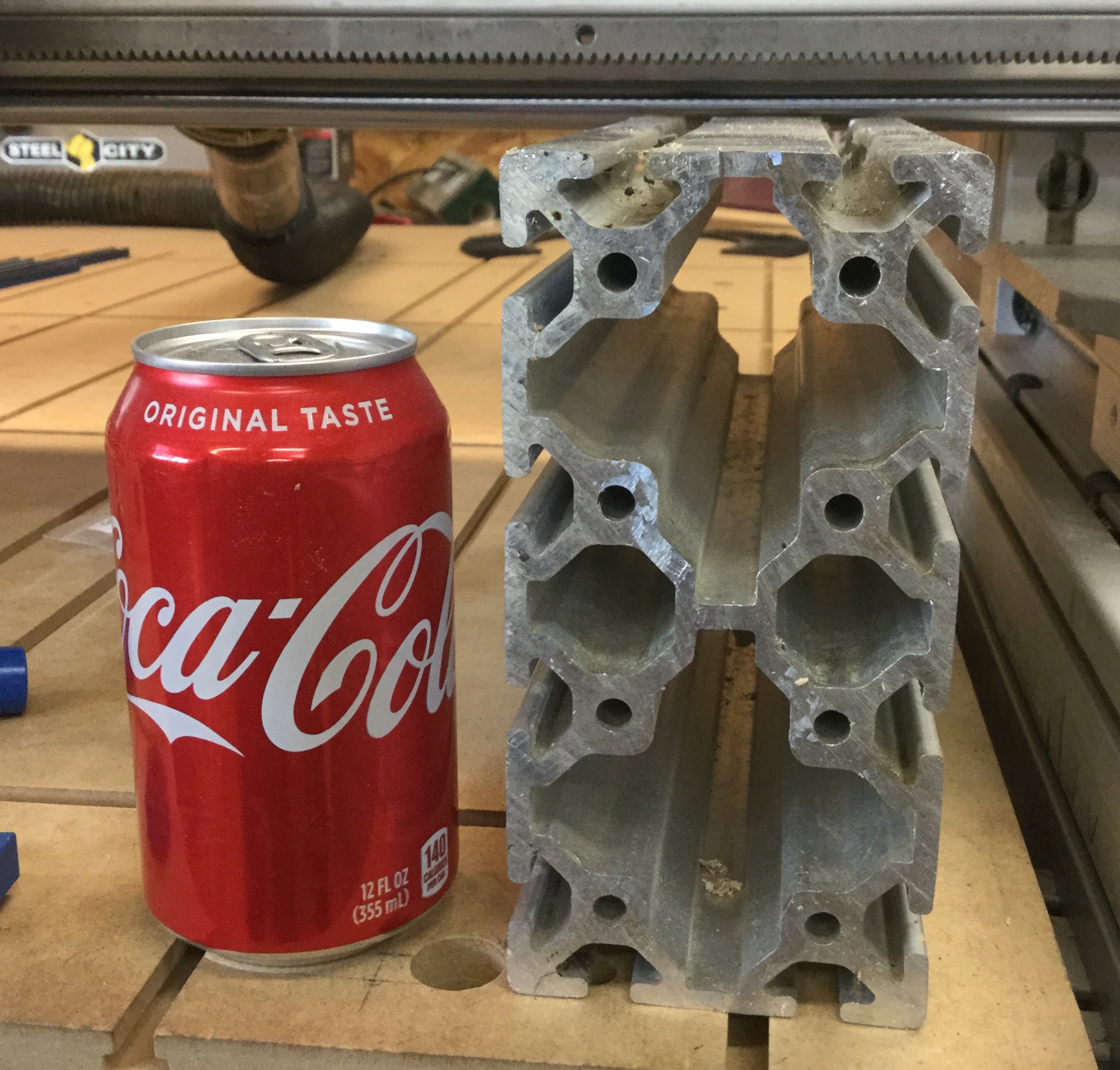

I don’t know how long the Dominator X axis is but an 80/20 80x160mm 60" long would cost me $327. Ouch! But worth it.
That picture is worth a thousand words isn’t it? The advantage to the big 80/20 is mass and lots of very strong places to tap for cap screws. You can even have 80/20 cut it to length and tap it for you.

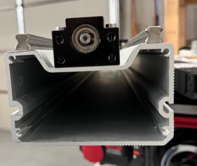

The AltMill Mk2 which is what you get now, has a horizontal piece in the middle. The Y has the same. Their engineers claim that their extrusions, which are custom for CNC are actually stronger than like sized 80/20’s. That’s what they say based on their finite element analysis models.

Here is my AltMill’s gantry extrusion… it definitely matches the 3d model i have of their machine from their website.
I agree it is custom designed for cnc machines, but dispute the claim it’s better.
