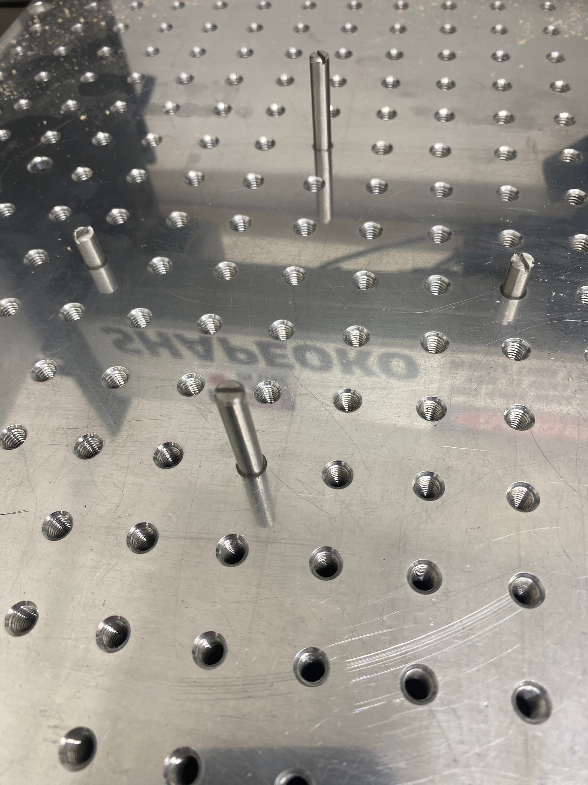

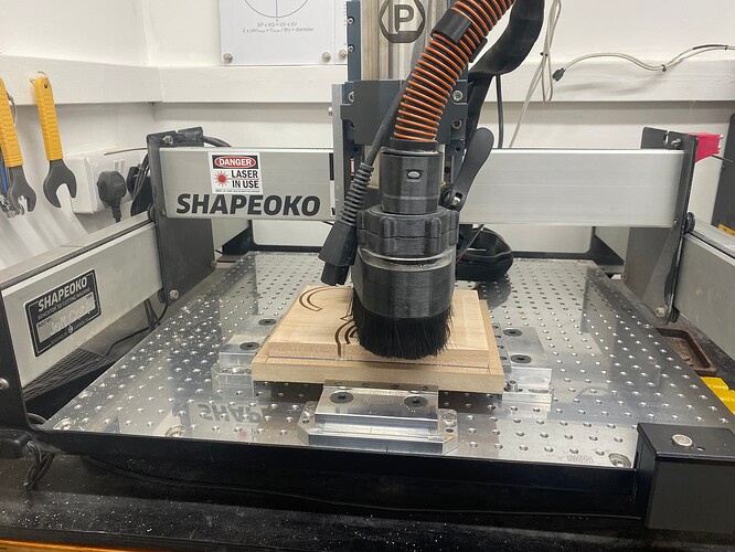

Is there any possibility that PwnCNC would consider working with Saunder Machine Works and creating a full-sized fixture tooling plate for the new series of Dominator machines?
I have one on my standard sized Shapeoko SO3 and it increased rigidity by an order of magnitude.The bonus was the 840 M6 threaded sea of holes at 20mm centres which permits use of the excellent modular vices supplied by SMW. Additionally, they can create fixture tooling plates with ½" holes that accept their larger modular vices.
Fixture tooling plate and modular vices

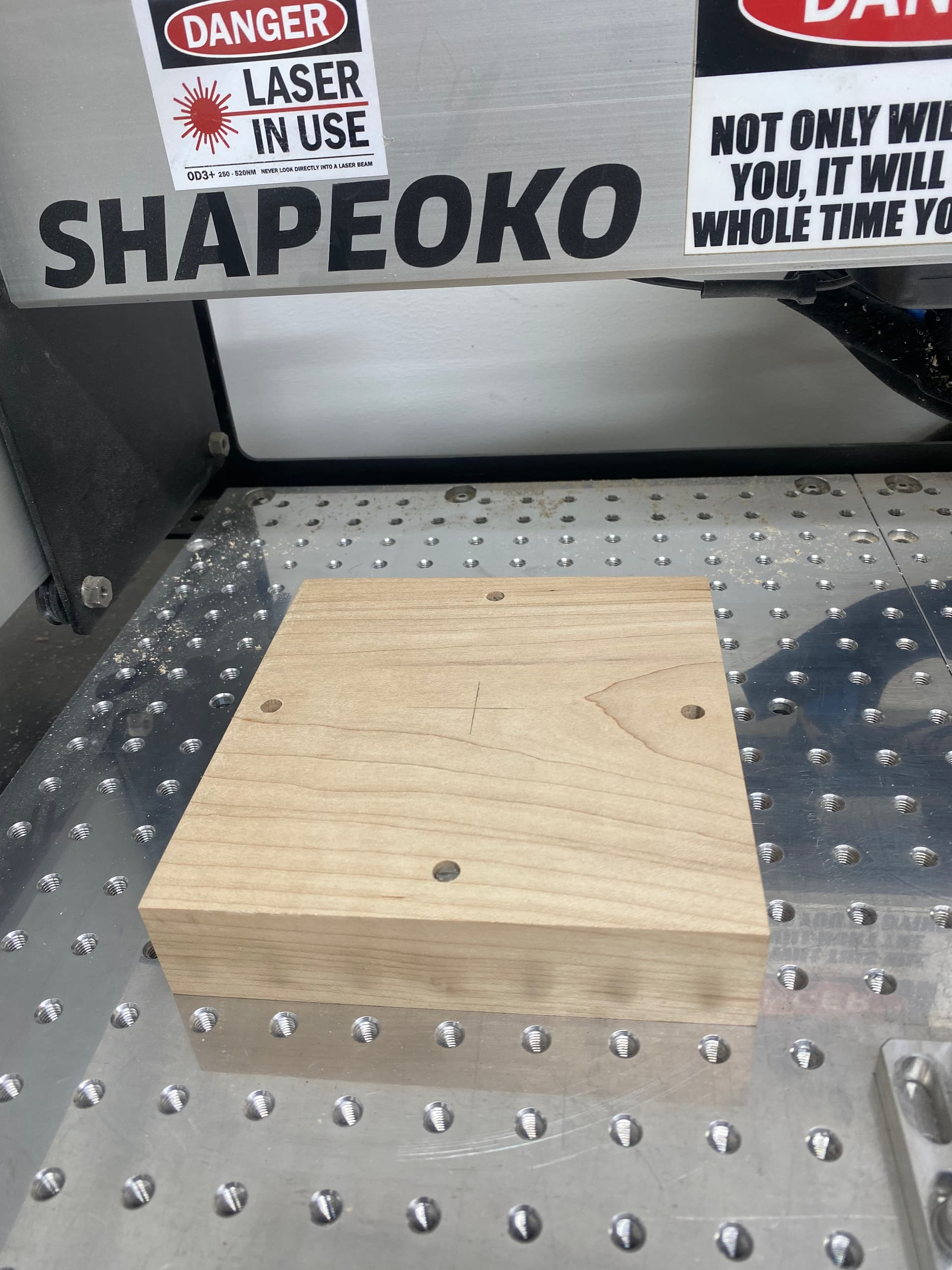

Index pin hold for 2 sided milling
Different length M6 idex pins
I’m sure it’ll be looked at after production machines have left the line but probably not while in preproduction.
Thank you, Chris. It is probably the one thing that would help me to decide to change my current machine set-up, because the work-holding, clamping versatility and machine rigidity helped me to get the best out of my machine.
