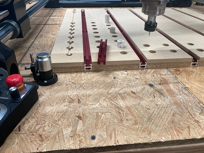

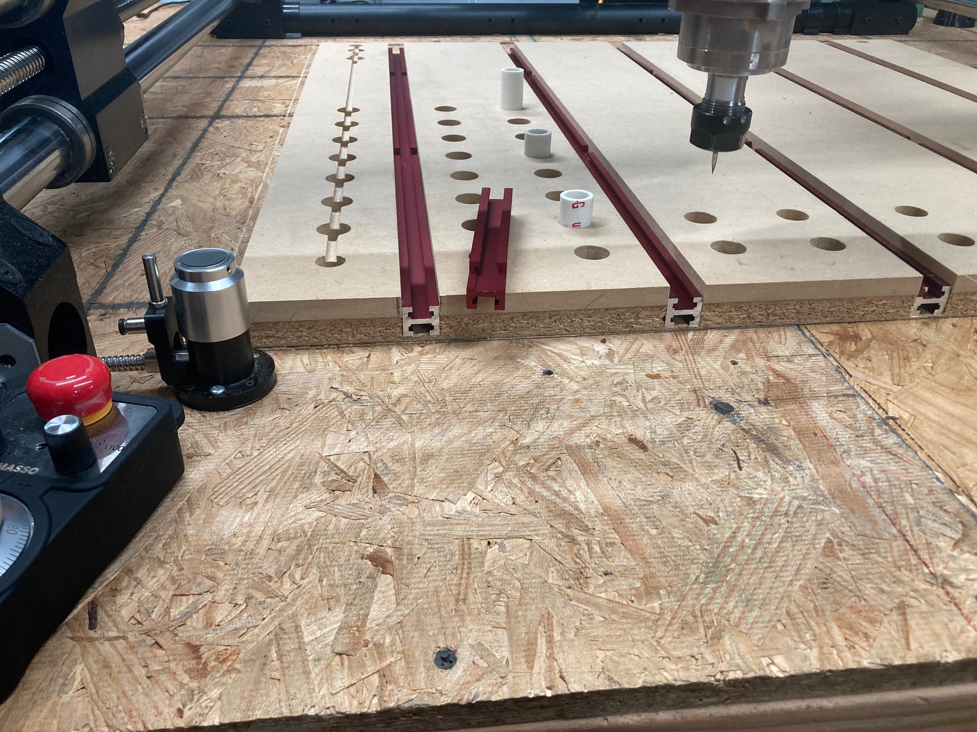

I’m trying out a new idea that, so far, is working very well. I glued a 1/2" sheet of MDF on top of a 3/4" sheet of particle board. I did this because I had both materials on hand and didn’t need the MDF to be full thickness.

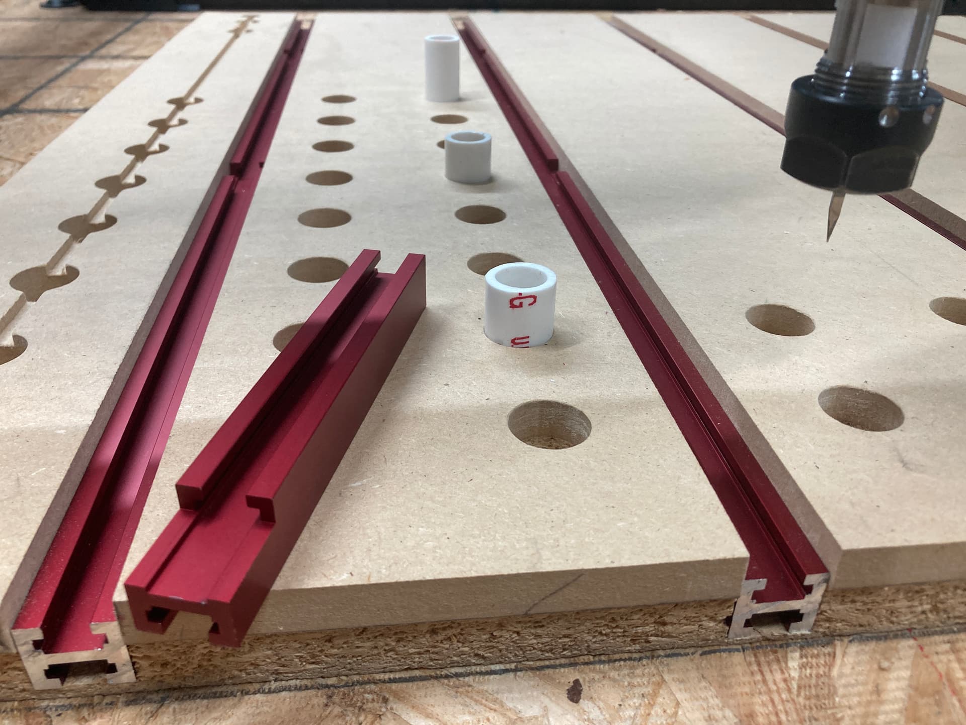

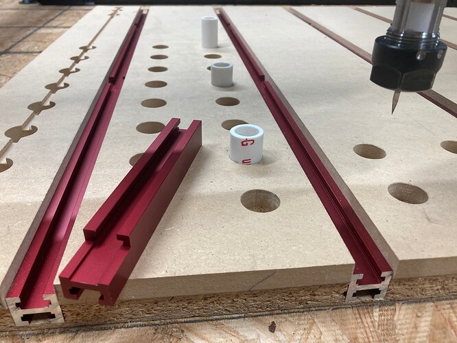

I then purchased what I know as “Double-Sided T-Track,” made by a company called Armor Tools. These tracks come with bolts that allow you to anchor them to a surface and include a top track for clamps. They also have cut-outs every 12 inches along the top, allowing you to quickly insert or remove clamps in the middle of the track. I could only find them at Taylor Toolworks—$13 for a single pack, or $8.75 each if you buy a four-pack.

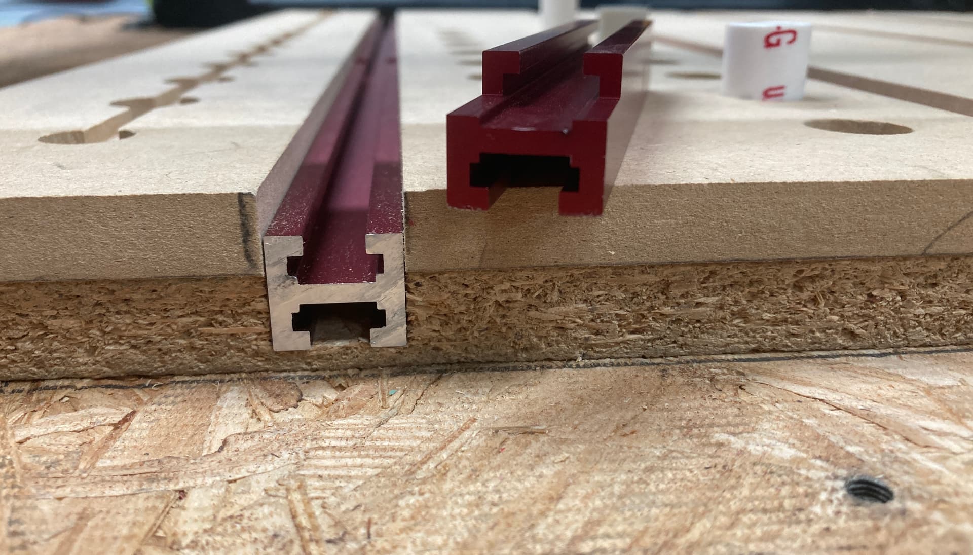

My idea for using them was to bolt the glued-up spoilboard to my CNC table using four screws—one in each corner, using just a hand drill as I didn’t need this to be perfectly square with the spoilboard. Then I used the CNC to cut the pockets for the tracks. This ensured that each track would be perfectly parallel with the machine. I cut the pockets most of the way down, leaving about 1/4" of particle board at the bottom. I also had the CNC cut the through-holes in the exact middle of each pocket for bolting down the tracks.
From there, I simply started each bolt, then “threaded” each track into its pocket while engaging each of the bolts, and finally used light force with an impact driver (making sure to use fender and lock washers) to pull the tracks—and the spoilboard along with them—down securely to the table.
Now I can clamp down as hard as I want, and the tracks don’t budge. When I need a new spoilboard, I just unbolt the current one, drill four holes in the corners of a new sheet, and rerun the pocket cuts.
