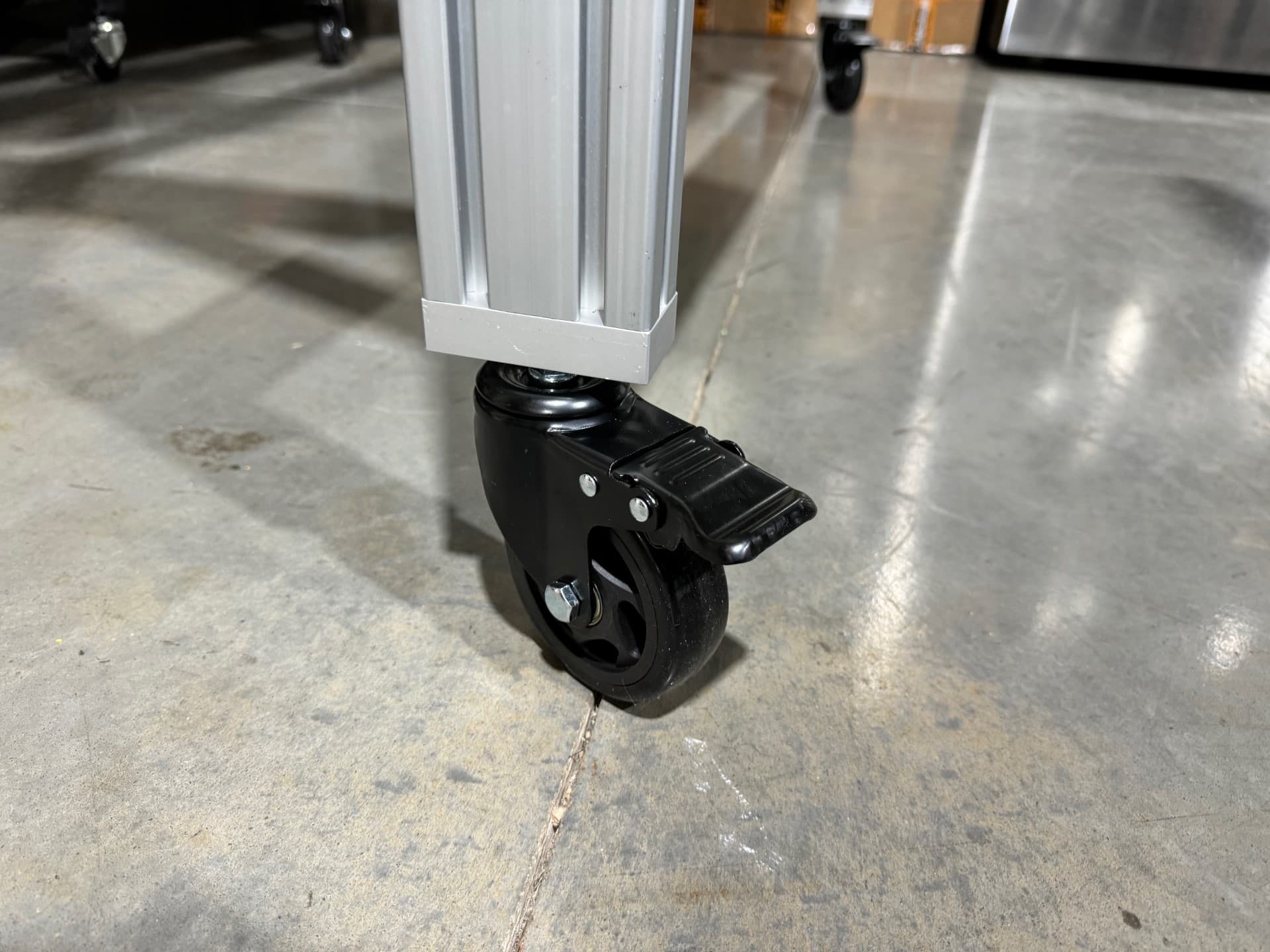

Adding Castors to our 4x4/4x2 Avid Pro
In the tight quarters of HQ… we need our machines on wheels in order to move them around as needed.
I worked with our 8020 dealer to replace the Avid “stock” stem-plates: 40-2130 | 40 Series 3 Hole - Center Tap Base Plate - 40mm x 80mm with M10 Tap
Combined with 1000lb castors off amazon: https://www.amazon.com/gp/product/B0CGKRZSYZ/
It does raise the entire machine a few inches, but is more than sufficient for our needs here.
