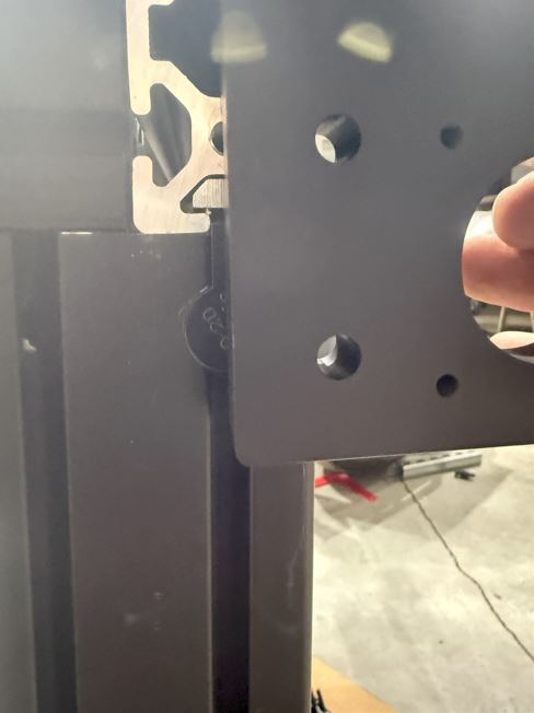

3rd M8 on rear Y mounts
For those with the leg kit, how did you mount the 3rd screw. The flush mount leg hardware is in the way
This would be in the rear. I’m working on an update to the manual now that shows this better.
In this case, leave that rear anchor off and use an M8 t-track nut there instead to hold the plate.
There are 2 anchors on each leg that are used… let me pull up the specific details.
This will help a bit…
But i have this on the black Dominator i’m assembling as well. The “rear” legs had 3 anchors instead of two. The anchor under the rear Y plate i left off and used the included M8 t-Nut instead.

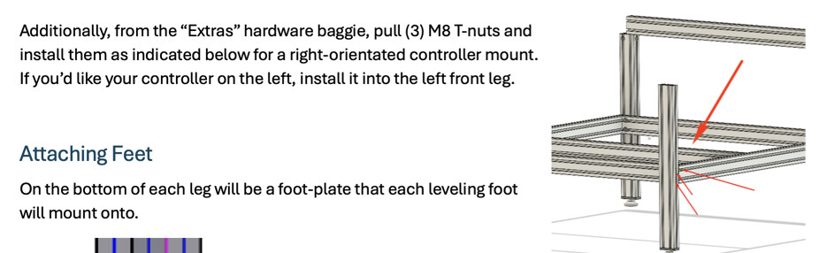

Also note dropping extra-tnuts into the front legs to hold the controller mounting steel bracket:
Did the standard t nut hold? Mine falls almost in the center of the milled hole. I may try to use the double nut to get more holding bite.
