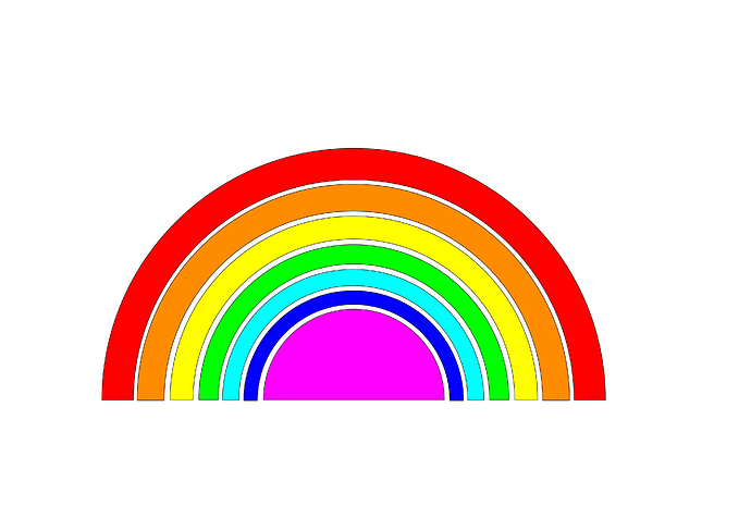

I drew a quick design in Affinity Designer and saved it without the colour as an SVG file. I separated the component parts and ingested them into Carvco Maker, where I output the GCode into gSender. I used a 3.175 x 22mm carbide downcut endmill from Rennie Tools and settings were 10,000 RPM with 0.5mm stepdown and 50% stepover and the spindle was moving at 1000mm/min.

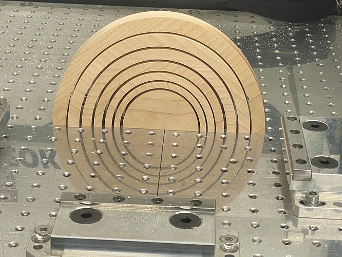

Overall… I think the project will provide hours of painting fun and the unfinished wood deals neatly with the issues around chemicals and toxins in items that are not kept by the person who made them. All comments are welcome.
Unretouched image of the final project.
