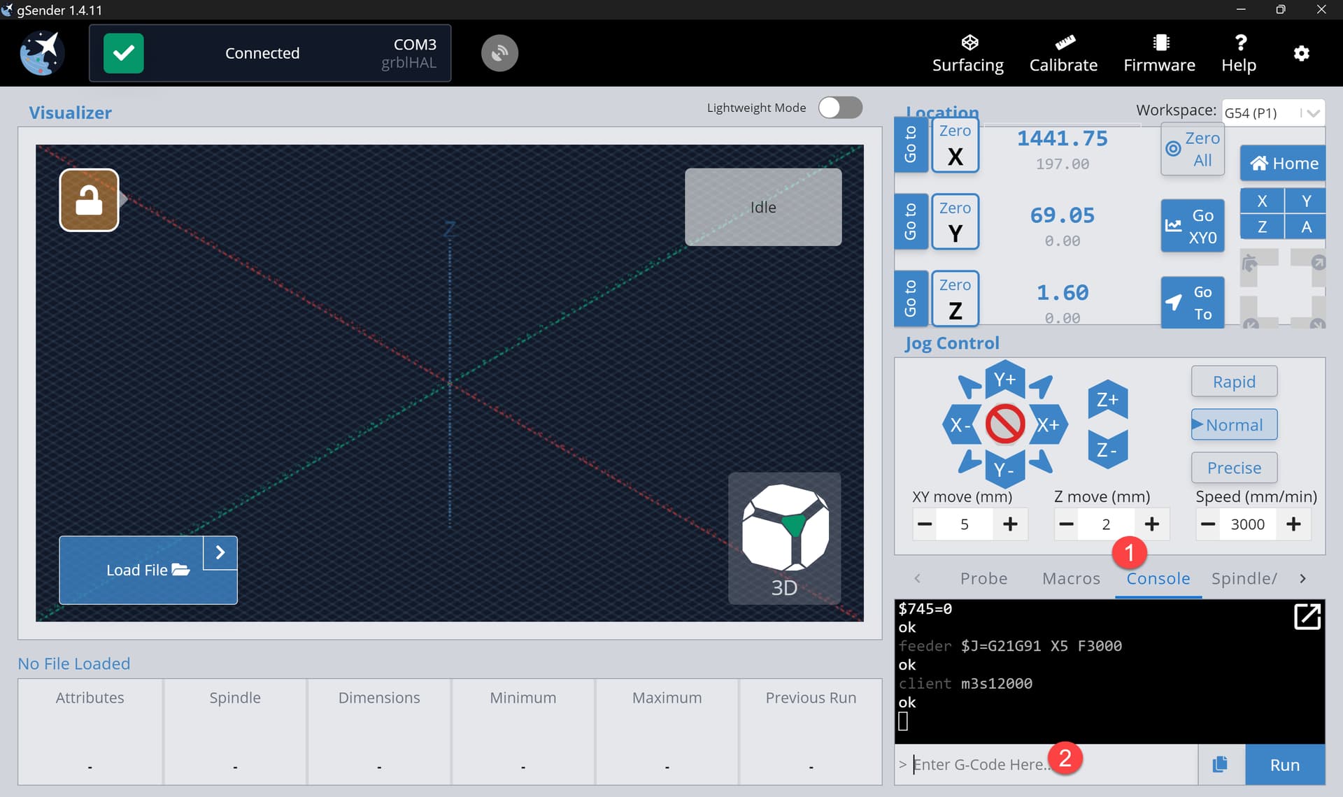

I can jog/move the spindle in X, Y, and Z directions but cannot get the spindle to run when I enter the console command m3x12000, last Friday it was working. Sometimes I get an Alarm 14. I have no idea what the heck I changed. Suggestions??

I enter and ran $RST=$
As soon as I click the Run button the spindle moved and I could Jog/Move the spindle as desired in all three directions.
A few days ago I could enter m3s12000 and the spindle would spin at 12,000 RPM until I entered m3s0 and clicked the Run button.
At this time, still, I cannot get the darn spindle to turn.
